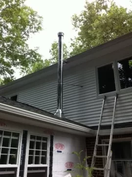

How come you went with a rear vent instead of going top vent? Rear clearance issue?
Not a clearance issue. I wanted a straight shot for the chimney and top venting would have put the chimney pipe over 30" from the shed dormer wall. Thought that might look a little silly.
