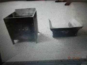

i started my changes and improvements based on info from everyone, i have designed a burnpot chute that not only funnels the stray hopping pellets, but also helps to seal the burnpot like ke5hde was talking about and it just sits in place without any mod.....check it out, hope you like

I'd like to see close up pics of the burn pot outside the heater. Looks like something I have been thinking about. Also... have you considered altering the box the burn pot sits in? I was thinking of grinding off about in inch down and an inch in from the outside edge, (on both sides) and creating a 45 degree angle for the ash to slide down. In my stove the ash seems to collect on the top of the box the burn pot sits on, untill it starts falling back into the burn pot.

I altered the burnpot too. Added pieces are about an inch wide. The added pieces seem to help flare out the flame and direct ash to the bottom where it belongs and help direct pellets back into the pot. The only thing I've noticed is the added piece at the front does direct the flame more towards the glass and does trap some ash on the door ledge. I think it would help to add a small vertical piece off of the angled piece on the front to solve that issue.

Hi Chris my name is Chris too and i have a 5510 King Pellet stove and i'm have some problems like you. First of all my ashes are all clumpin up in the burn pot so i drilled the holes in the burn pot bigger and that helped a little bit . And my next problem is i dont know how to slow the pellet feed rate down when i turn my heat range on 5 the burn pot over flows so i did what you said to do i tightened the screws to the 2 slide doors and then i caulked the 2 slide doors so they won't open the ones that you pull the handle to let the ashes drop into the pan and i would like to know how to get more heat out of the stove. We also have a big old house and it just seems like we are not getting enough heat and i also would like to know how to turn the heat temp up by the buttons because in the owners manual it doesn't tell how to do any of this so if you could please give me some information on how to change a few of these problems or fix all of them i would greatly be in your debt [ My e-mail is ChrisHuff80@yahoo.com and please send the same message to jkblove614@yahoo.com ] Thank you for your time and help
here are some pics of burnpot mod which i suggest works good and increases air flow so i can run on one lower draft setting and can go a week and a half to two weeks in between cleanings ( depending on what heat settings i am using ) and also stopped the pile of pellets that hop out of the burnpot and dont get burned

notice the extra piece that fits in the groove of the front of the pot.... allof the welds are on the outside so it fits the burnpot tight. i actually held it on the pot when i welded it so it was a perfect fit. i bought a 1 inch piece of stock from lowes the same thickness as the burn pot.... three feet long i think, based on performance, i might make a new one decreasing the angled top enough to clear the metal on the back wall where the pot holder bolts on which will also decrease the amount of ash that collects on it....... enjoy and if you got questions, go ahead
