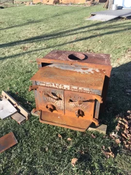

I'm new to the site and it seems like there is a ton of knowledge here! I was wondering if anyone else had an issue finding the correct size Chimney pipe for the stove i purchased for my cabin. I found an old Kodiak wood stove that needed a ton of TLC. But i love old wood stoves, i just think they're so cool! so i bought it, Sandblasted the exterior, Heat painted it, replaced the firebrick, & replaced the gasket. I'm trying to find the correct size stove pipe, but the opening (collar) on the top of the stove is 7 5/8" and the actual opening to the stove is 6" Can anyone help me or point me in the right direction?

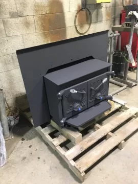

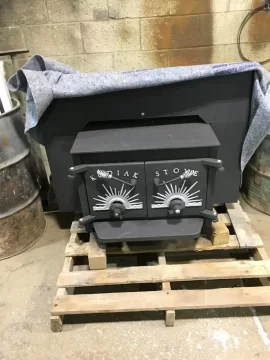

[Hearth.com] Kodiak Wood Stove Insert [Hearth.com] Kodiak Wood Stove Insert [Hearth.com] Kodiak Wood Stove Insert [Hearth.com] Kodiak Wood Stove Insert
Looks good. It cleaned up nicely. This is an insert. It needs to have a full stainless liner in it. Stovepipe is not permitted in a chimney.

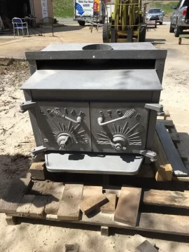

I recently acquired a Kodiak that looks to be the same model as yours... although not as beautifully restored!
I rebricked the interior but I'm struggling with the gasket. What diameter did you use? There was no gasket in place. Is it possible this Kodiak was designed without gaskets originally? The ones I bought seem too "fat".
Also, do you use a fireplace grate in yours? Does anyone?
I got lucky and found the old (original?) screen in the garage in pretty good shape.
