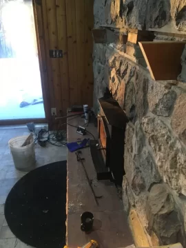

Insert pics hooked up in old fireplace, I’d like to nose it out a bit more, perhaps an offset.

I’m unsure the exact way to measure your draft, I’m pretty convinced I need a damper or something. I know that if you open the bypass and the air control open and open the door if feels like it could suck your shirt off.

I'd like to see a better pic of what you have connecting to the stove. If there's an appliance adaptor before it hooks to the liner, maybe you can put the damper there, then just run a rod to the front of the fireplace to open or close the damper?
There is an appliance adapter hooked to the adapter on the top of the insert that sticks up 2”, which can be removed. But I’d like to put an offset adapter on to nose the insert further out. It’s maple, there was spaulting and medullary rays in it. Would have made rather pretty boards. I did save a bit to perhaps take to the sawyer. I do hand tool woodwork in my spare time, but for now trying to get better burns and a more heat,
The offset adapter will complicate sweeping the liner. Sweeping from the top will leave creosote crumbs in the offset, that you have to clean out through the box (if you don't want to pull the insert to clean.) Sweeping from the bottom with a Soot-Eater will be out, I think. If you have room to put the damper in the appliance adapter, you can just run a rod to the front, no sprockets or anything complicated. Or maybe if you are going to leave the surround off, you could reach the damper handle with your hand. Looks like it would be an arm-scorcher though, unless you have a welder's sleeve you could slip on your arm.
I don't think nosing the stove out will give much more heat. Are you using a blower? That should pull the majority of the heat off the box. But their "natural convection" design seems like it should work pretty well, so I can understand you wanting to bring the stove out to take fuller advantage of that. Or maybe you can use a couple of small computer fans blowing toward the air ducts to enhance the movement of heated air out of the fireplace?
