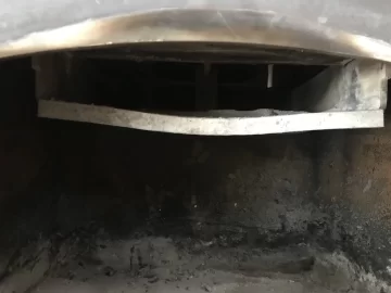

Before I installed the insert I was thinking it would be hard to tame the fire with the chimney run but my experience has been the opposite. I have no trouble at all shutting it down and even suffocating the fire altogether with the intake. I think the 2 offsets (4 - 45 deg turns) help slow it down. Im really happy with the heat and performance I just want the baffle set to last.
How many burn seasons have you gotten out of the baffle. Remember it does see some pretty extreme temps. Like begreen said maybe reach out to Kuma. I would be curious to see what they say.
I would reach out to Kuma but... its Saturday night. Plus, if they had a fix then I would have expected Jason to mention something earlier in this thread. My guess is, Im on my own on this one. Im fine with that, Im hoping someone her can tell me if there is a heat treatment that will correct this other than going with Ti. If not, Ill have to look at other options. 1-2 years of baffle life isnt an ideal option.
Keep them in the loop. It's in both of your best interests.

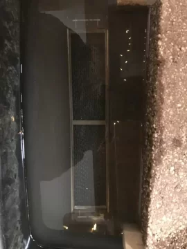

Further updates, I did clean my catalytic today with vinegar and a water bath reawakening it. I also did other maintenance, chimney swept, I do that twice a year. I get some creosote build up on the cap, yes the wood is dry. Cleaned the area behind the cap. Some ash collects behind there. I think Once a year ill pull the cat to get behind there and maybe not bath the cat but give it a good cleaning with the air hose.

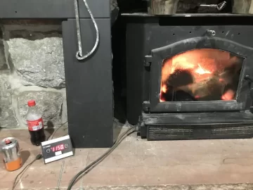

We did hit 1250, the cats working as well as it ever did. Yes, the bent baffle makes the stove seem like it’s smiling.

I have never given my catalytic a bath. Do you think it wwwas worth it? I have replaced mine once in 7 years I have had the stove. I can not get my cat to seee those temps, my stove burns between 700 and 1000. I have only seen over a 1000 a few times. Kuma has told me that is not a bad thing and every setup is different. Are you still happy with the stove/insert? Do you think you will replace the baffle?
Overall still happy with it, I do thinks it a good idea to clean it, worst case scenario is you just wasted some time and a few bucks buying vinegar and some gasket. I have quite a tall chimney, so maybe my draft is stronger making the temp higher. Did your baffle warp too? Have you ever replaced yours? I consider it, and I may take it somewhere. I’m worried about buying a new one just to have it happen to the new one.
I burn quite a bit of wood in a given year. I do notice slight ash buildup behind the catalytic. And I do get masking on the cat,

My baffle has not warped, maybe because my temps are not as high as yours. I can see your thought on not replacing it incase it happens again, if it is working why mess with it. Other than the cat and the glass gasket I have not replaced anything else. I think after this burn year I may replace the door gasket I have it I just have not done it yet. I do get some ash buildup in the front of the cat, every few weeks I check it and vacuum it off. When I clean the stove and the chimney flue I sweep behind the cat there is a little ash but not much.
