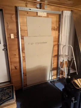

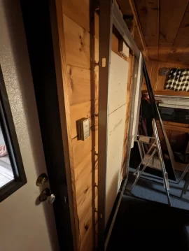

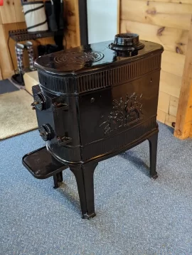

So after having a chimney sweep come by for a pre install. This is what I came up with so far.
[Hearth.com] Lange install [Hearth.com] Lange install
@Russell62 I moved your posts to their own thread. They go lost in the other. That looks like a nice Lange 6302A. It will need 36" clearance in all directions without wall shielding. That can be reduced to 12" with the proper NDPA 211 wall shield.
