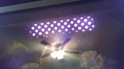

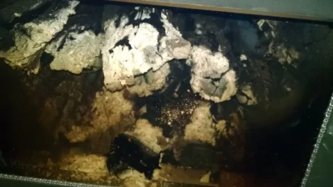

Guys, I burnt with tube stoves, YES, low end brand but technology the same as the expensive ones. Some brands have ceramic board, other ceramic blanket, SS, bricks etc. they all work the same. I was able to keep the house real hot till the point that it feel uncomfortable. At least for me and my family. But for that to be possible i have to reload every 4 to 5 hrs and take all that temp rising and talking to that secondary burn takes off on those hot reloads. The stoves were into the living area where we spend some quality time. At night i always the last one going to bed, cause i have to reload for the night.
Get up early cause just some coals and the house dropping like crazy. Again 4 to 5 hrs window at most when cold outside. I said, i need to stop. This is it. I am better installing the propane furnace that i ripped back and pay for the propane. At this rate i was not seeing any differences between wood consumption and all this work. For me was not worth the saving. Including CSS my own wood, was not worth it.
The cat stove changed my life and i am now able to sleep, save, stay warm with a more comfortable and more equal temp around the house. Now We watch movies in the same room of the stove, spend more time in the family room all together and everything is good. Before everybody used to go to their rooms and let this crazy old man toasting alone. The other stoves were just putting lots of heat up the flue cause metal can transfer some X amount of heat in those 2 to 3 hrs. if those BTU those stoves are rated, they really put them out in that short period of time they will be glowing and melting.
A good percentage of that heat is going where? i don't know, I used to love to see secondaries on those stoves but i will keep the ugly one. after all i did joint the dark side. here are some pictures after reload for almost 3 hrs into the burn at this temp and no flames. My tubes used to burn the whole box in that time.
What stove were you using? Those burn times are really low. I easily get 8 hours of good use able heat. And have enough coal to reload on with no kindling after 12 hours.
The stoves i was using are on my signature. I really can get more time than that and maybe i exaggerate a little but i am not that far off. The coaling stage after secondary was not enough in some cases to keep the house temp and all that heat used to go i don't know where. The back of the house always cold. With this stove it is different. I installed flue damper, including i installed for a few days a barometric damper to control the draft better. also bought a manometer, get with tech support multiple times. The best control over was the installation of the barometric damper keeping the draft to 0.05WC or what ever was recommended. I should have pictures of the baro damper installed.
But at some point of the burn if i load that socker tight little by little will take off those secondaries and the baro pegged all the way open. i know that it was not recommended for solid fuel and i end up taking it off. My draft for some reason is strong. I block the dog house, the holes for the the secondaries i blocked them a little, i just tried everything. When temperature used to drop teens and under that was an inferno. Burnt E/W, N/S load tight, load loose.
I did make an appointment to see a psychology.lol. but the BK shows in time and i got cure.lol.
