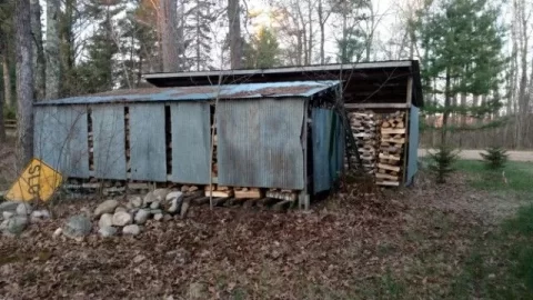

The most important thing to know about energy is conservation. Reduce your need for wood once, and the payback is lifetime. All the home improvements are important: insulation air sealing, windows, doors, etc. Then an efficient wood burner, whether it be an interior wood stove or a wood gasification boiler with adequate storage. Next wood storage and shed.

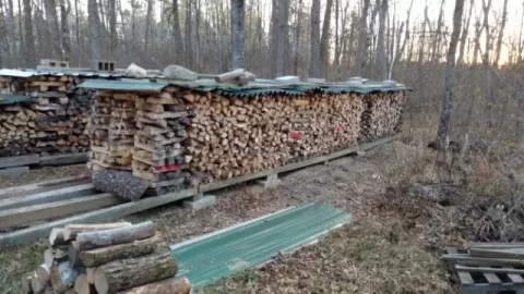

The easiest and highly effective wood storage is outside stacks with good air circulation, stacks raised off the ground to allow air circulation underneath and shield from ground moisture, and then add cover to keep the rain/snow off the stacks: roofing panels work well because they allow air circulation across the top, but never tarps. As noted below, that's what I use for the wood for my shop, stacks 4+ feet wide and 32 feet long.
I too do not want to handle/stack wood more than once. And also I want two years of wood on hand in weather protected wood sheds, three would be OK but excessive. Yesterday I finished c/s/s to fill my wood shed for the house with the wood for 2017-18, wood for 2016-17 is already in the shed. All of this is to heat the house which takes 4 cords/heating season in northern MN, mostly aspen, some birch, oak and miscellaneous.
I also have a 1500 sqft shop which similarly takes 4 cords/heating season, but no wood shed for the shop, just roofing panels over the top of the stacks to keep the rain/show off. Stacks are 4-1/2' wide of 18" splits, 32 feet long. Two stacks hold 8 generous cords. Wood for 2016-17 was c/s/s early last year with all summer to dry and will be well seasoned by fall, wood for 2017-18 is in the process of being c/s/s right now, mostly pine, some hardwoods.
I wish you well on your wood storage project.
(broken image removed)

Jim, the photos do not appear to have come through on my browser. Anyone else have this problem?
What about maybe leaving a cord or three in a pile on the ground next to the splitter for 4-6 weeks to let it dry down to fiber saturation point, and then stack in the conveniently nearby woodbarn?
ditto.

Hope this works better on the pictures.
[Hearth.com] Large wood shed plan [Hearth.com] Large wood shed plan [Hearth.com] Large wood shed plan
