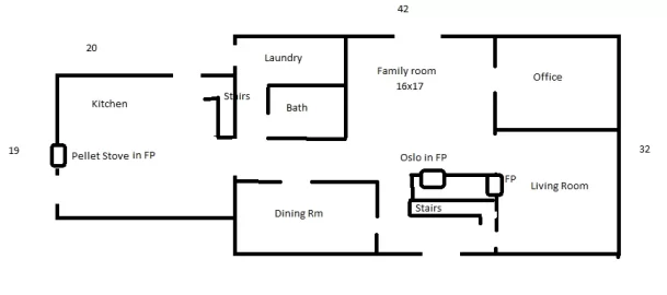

Did you run the pellet stove on high during the very cold weather? If so that should be a steady ~40K btus. If that didn't work, changing out the Oslo is not going to make a lot of difference. Maybe this is a circulation problem? Post a basic sketch of the floor plan that shows the locations of the Olso and pellet stove.

I was thinking of putting a ceiling fan in the stove room to circulate air. I've tried the small fan on the floor blowing cool air to the stove and a fan being the stove in the FP but it doesn't seem to help much. A sketch of my floor plan is below. The upstairs has a hallway going from the kitchen stairs to the chimney area and then around to the front of the main staircase which is pretty open to the floor below.

The location of the Oslo is very central and should be almost ideal for heating. What's your main problem; getting the heat upstairs? Where did you place the fan(s)? One about at the location where the pellet stove is would get the heat to move over to the kitchen and probably also up the stairs then. You could try one in the entry at the corner to the dining room blowing cold air towards the family room to maybe get some heat up those stairs. A fan on top of the stairs blowing cold air down may also move some more heat upstairs.

That is a pretty nice setup. The Oslo is well centered, though I can see how the entry hallway and stairs would not get the full convection due to the doorway. You are getting good recommendations. I would try another season with the Oslo but will either known dry wood (kiln or barn dried) or a high quality compressed fuel like BioBricks, Ecobricks or Northern Idaho Energy Logs. You should notice a significant improvement in heat output.

A ceiling fan in the stove room might help. Or perhaps try to get the air to convect using a table or floor fan, on the floor blowing from the living room into the family room? I too would consider having an oil filled electric heater or two upstairs to supplement.

I wouldn't say the main problem is moving heat. I think if it were 5 degrees more on the main floor we would be alright. Also, the fact that the stove is so cool by the time I leave for work in the morning is a problem. I would load the stove to the gills at 10PM and when I get up at 5AM it's not putting out much heat. I'm not sure how much dry wood will help with that.
