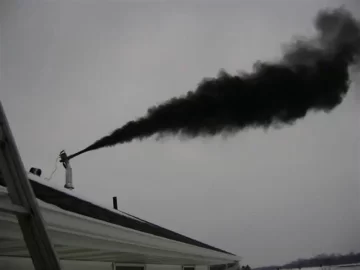

heres mine, no field stone but it is a 2 story home with about 26' of vent.
Now THAT looks like fun! It looks like the old days when I was on the USS Forrestal and it would blow out it's stacks occasionally, albeit this is on a much smaller scale, but still.... I'm definitely going to have to try that someday. I can't wait to see what the neighbors will say. I'll make sure they're in their backyard so they can get the full view of my antics...
That's such a great pic!

A town inspector or a irate neighbor see's that and you get a fat fine!!
it all settles to the ground just the same as dumping ash in my yard.
besides I live in BFE don't have any neighbors.
