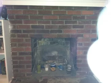

I know! Sell me your 602! Just happened to think of domething else... I have built in bookshelves on both sides of the hearth- about 12" from the fireplace openings. They extend 8" out. Will there be a side clearance issue? I'll post pics once home. Can I ipload from my mobile or do I use a photo host like Flickr?
Clearances will definitely need to be considered both to the sides and to the mantel if there is one.

25" w across the back
29" w across the front
24" h
16" d
12.5" side clearance to bookshelfs
19" top clearance to mantle
There is a strange offset jog in the chimney with a small opening. Looks like a few bricks could easily be removed.
