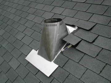

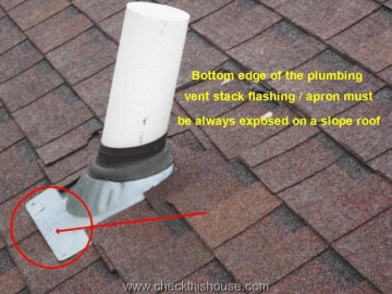

Yep, the chimney flashing/roofing job is botched. You should see the bottom of the flashing on all of the roof jacks. Check your plumbing penetrations too. Makes me suspect the rest of the roof and I have another peave, nail heads. You should not see any nail heads on the job except the very center top of the ridge cap. Little gaskets or roofing tar over the nail heads is not the right way to do it.
