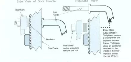

Brandon here is the adjustment you can make if your seal on the door is not tight enough.

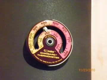

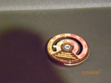

These are the thermometers we have on the stove top and (single wall) flue coming out of the Liberty into double wall.
