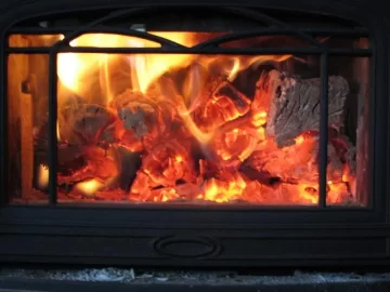

Something isn't right! I loaded up the T6 at 6 am this morning stove top was 250 and the house was 69. I pulled the coals forward and lit off the front of the load 25 minutes later the stove top was sitting around 650. shut the air and left it about 1/3 of the way open, turned the blowers on high and the stove top dropped to about 500-550 (I'm quite certain if the blower was off the stove top would be pushing 750). I attached some pictures to show you I haven't burned quite 1/3 of the load yet and it is still sitting at a stove top of 550 and has now sign of letting up house temps have come up to around 73 degrees.
I know you can't tell it from the pictures but the all of my flames and orange glowing is just on the front of the logs, those logs were almost touching the glass and they have burned to ash 4 to 6 inches back into the stove. with whole formed logs still right behind the orange flaming front pieces. I am wondering if you are setting the stove up to off gas the whole load very quickly? I know after burning in my Dutchwest it took a while to get the hang of setting the stove up correctly to burn front to back but now it's second nature and takes just a few quick seconds. In the defiant and the dutch it doesn't' matter as much you just light the load up and then shut it down due to the fact you need the whole firebox heated up to get the cat light off. The key to getting the long high temp stove top temps is to set it up so the load burns from one end to the other. Do you have a flue probe in your stack? I really think the flue probe is one of the best learning tools to let you see how the stove is responding.
I agree with Oldspark I keep enough ash to carry coals but the stove need to be able to get that doghouse or boost air to keep the ends of the logs burning up from the bottom.
  • [Hearth.com] Limit of stove top temperature on NC30
I started a post about how my old smoke dragon was beating my EPA stove ( englander 30 ). The old stove without question put out more heat than the 30. I went back to burning coal in the old stove and kept burning wood in the 30. Both stoves are in the basement. The 30 wouldnt keep the house warm enough alone, but with a little help from the coal stove it does fine. I also added a flue damper and I think that helps keep the draft a little slower so I can get longer burns. I have a 30 foot chimney, so thats not for everyone. Dont let anyone make you feel bad about your dissatisfaction with the 30, it probably isnt big enough for your application. But I wouldnt rule out some more tinkering either.
If I start the blower, the top will max at 450. Right now I rearranged the logs that were on the edges and the stove looks like your pic. Top is mid 600s. I did move coals to the side on loading this morning. The logs I just moved were opposite the coal side of the load.
