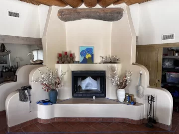

Originally, I hoped for an insert. However, it seems hard to find a compatible unit to fit into the heatilator fireplace.
Then, my goal was to leave the fireplace in place and route the stove pipe up the original chimney and use a freestanding woodstove like the Jotul F500 or Osburn 2000 out in front of the fireplace. Not sure about the stove yet. The idea was to 90 out of the stove to a tee below the existing stove pipe (inside the ZC fireplace) and connect to a 6" liner up the existing stove pipe. Then, I would cover the fireplace with some type of non-combustible facing with a thimble in it. One installer said this would work.
The other installer I spoke with said exactly what you said in your reply. He said to remove the ZC fireplace and existing chimney and then run new pipe. This makes the most sense to me. Looks like the fireplace will have to go.
Attached files for a before and after (sketchup drawing) of what I was thinking.

Not sure if I should begin a new post but...
Is is possible to demo/remove the existing Heatilator and frame a non-combustible box in the space and install an insert? And then install a new 6" class A pipe?
Nope it would need to be a built to code masonry fireplace
