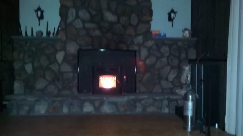

Congrats on the insert - pics or it didn't happen;)
this is the Timberwolf insert in the basement have the p43 upstairs only heating hot water now .I'm stoked !
