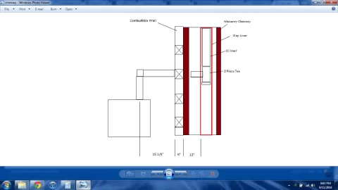

I uploaded this goofy microsoft paint picture of my situation
I spoke to a stove shop this morning. I told them i was planning on running a thru wall insulated thimble directly to a tee/chimney liner. They said the thimble wasnt made to connect to anything, just to dump into a masonry chimney.
What is my best course of action here? Do i need to scrap the insulated thimble? Do i need to install masonry 12" around the perimeter of the opening instead?
Is there really no way to run an insulated thimble into a chimney liner?
The stove shop has no idea what they are talking about. That is what they are made for they are made to safley pass thru a combustible wall to a masonry chimney. You then pass your snout that is attached to the tee through that thimble

how do you fasten the snout to the thimble? does it just slide in and thats it? no hose clamp?
is it safe to assume the front section of the thimble will accept a double wall pipe?
You dont attach any thing to the thimble it is just an insulated conduit for the stainless

ok, its just a sleeve.
so i just need to buy a thimble with an ID that will accept my piping's OD ?
would the installation process go something like this:
1. install liner with tee
2. install tee snout, tighten fittings from the inside of tee snout
3. install thimble, secure it to masonry, secure it to outside wall
4. run piping thru thimble and into tee snout...?
how do you fasten the pipe going thru the thimble to the snout?

You will attach the proper amout of stainless pipe to the snout before you put it in. There should be at a minimum 1" of stainless sticking out past the thimble.
