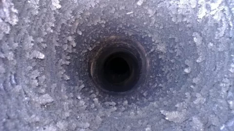

Just like webby said, you can see where the insulation ends, see this picture of my liner you can see exactly where the insulation ends and the buildup starts a couple feet from the top. I have since stuffed roxul down it.
