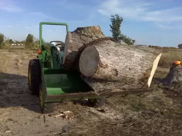

  • [Hearth.com] Loader Bucket Extender to Haul Firewood.

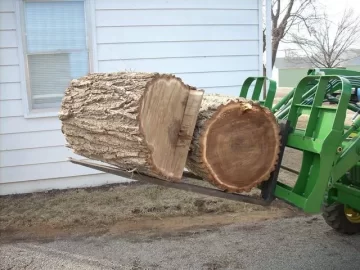

Hey wetwood . . . that one on the right . . . how'd that split?? ;-)
Here's a bucket load of wood from brought up from my stockpile to be staged on the deck for burning in the King. I find that if you take the time to stack it up in the bucket, you can load quite a bit more. However, I really think the pallet cube/box method will be the next one I try. Move 1/3 a cord up at a time and then reload when empty.
-Mark
Those splits aren't pretty but they will burn just fine. :)
