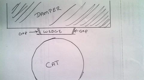

[Hearth.com] loading and stuffing a firebox I've got a Vermont Castings Dutchwest Sequoia which I rebuilt this summer. (the inner top plate had warped and cracked.) I'm wondering if I have a draft issue because my all nighters haven't been doing too well. I generally have a good bed of coals that I load my splits onto; as much as I can get in. Then I close the air down. (that may be around 11:00 - 11:30) I get up to check the fire around 2:45 (lately) and add a few splits to it. Then get up for the day between 6:00 and 7:00 and there is generally a decent amount of coals.
The new design for the inner top plate has a "wedge" shaped "cut out" between the cat and the secondary damper. A "wedge" of iron, bolts into the cut out. I'm thinking the fit is not snug, with a bit of a gap (about 1/8") on either side. Could this "gap" cause enough of an air leak to prevent me from controlling the burn better during the night? If so, should I use some furnace cement in the gaps and seal the sucker up?
Thoughts? Thanks!
