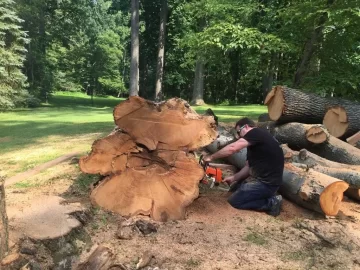

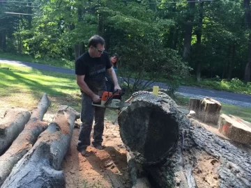

Did some cutting in the heat yesterday. Photos are of a friend using one of my saws. He's not much for PPE, at least in that heat.

36 inch Stihl Rollomatic ES
