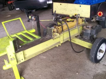

Hey guys. I've been cruising on here for a while trying to look for a decent log splitter and came across this one below on craigslist.
(broken link removed to http://boston.craigslist.org/nwb/grd/4962688753.html)
I value a lot of you guys's opinions and wanted to see what you thought about it. I've gone back-and-forth with a couple emails and he will let it go for $4300. I haven't been able to find much info on this brand log splitter and was also wondering if anyone has heard anything good or bad about them.
Let me know your thoughts it would be much appreciated. Thanks in advance

That unit is almost a kissing cousin to the Timberwolf TW5 with the added log lift. $4300 in the used market is not out of line considering the visual appearance of the unit (not beat to heck). You are looking at a commercial grade unit intended for pretty high production. Basically it is just one step under a small processor.
All that said - thatsallota money for a log splitter for home use. A "decent" log splitter could be had new for much less money. Its your money, but if the intent was to stay under 10 cords per year (128 cuft, per), this is like scratching your nose with a track hoe. A bit overkill.

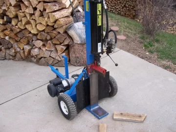

That's nice! Is it worth the extra $$?
Don't know. It cost me $50 for the electric lift and a little time. I built the whole unit. I don't even know what a lift option would cost for a factory built unit.

It looks like the throw is a bit on the short side. Make sure that your preferred length will fit.

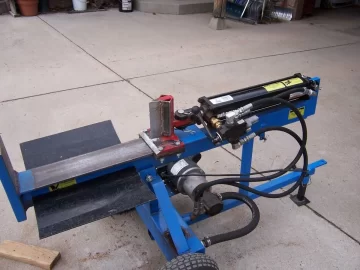

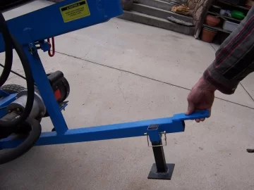

After looking over the pictures, I personally would not get a unit like this. Just my personal opinion mind you, but there are two things that I like better in my splitter.
The first is the valve setup. It seems for each function there are two valves. So to return the stroke, it takes a different valve. I can not tell from looking, but if the return stroke is not self-returning, then you would have to stand there and hold it in the return position. On my unit to return you just push it back and it stays in the return position and pops into neutral when done, so you can be getting another round while it is returning. Over thousands of cycles, this saves a bunch of time. It would be a must-have for me.
The other question is the weight and balance. It looks like most of the weight is forward of the wheels. This would mean the tongue would be very heavy. My unit is balanced over the wheels. I can pick the tongue up with one hand and wheel it into the garage when I am done using it. This is very convenient for me.
If you are cutting big rounds, I like the vertical conversion feature. It takes about ten seconds to flip it.
Hmmm...I am pretty sure that is not how it works. One valve will run the ram (on a machine like this, possibly even an autocycle valve), another for the adjustable wedge, and yet another for the log lift. The 4th could be a power beyond port to run something like a conveyor (or simply unused).

Thanks. Good point. I did just ask about the self return feature. I'm not sure why there are 4. I know it does have a hydro wedge lift as well as the hydro log lift. I'm not sure if the wedge or log lift has a separate lever for other direction. I just shot him an email thou.
I don't plan on moving it around much but where I split isn't so level and a vertical splitter was a little struggle holding logs there until the wedge made contact. ( I borrowed a friends to see how I liked it)
It's a prince rd5000 auto cycle valve. The other valve is for the lift and wedge... Pretty basic setup on commercial quality splitters.

Do you have a battery on splitter to run the electric winch, or use a separate battery?
The splitter is an electric start, so I use a deep cycle battery for both the lift and the engine starter.
