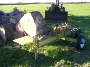

No! I don't crawl around well. I bring the log to me via a log lifter. More than one way to skin a cat.
  • [Hearth.com] log splitter gas or electric
