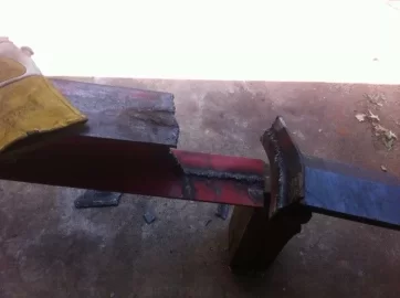

Here's my beast. He's a homemade (made it myself as my first and to date only welding project) fella that will split just about anything I put in him. As you can see I only hire the best little Scottish gremlins to work the lever for me!

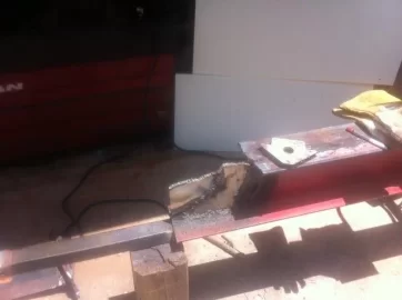

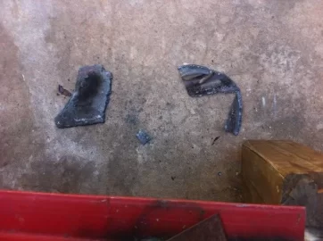

One problem though, i need to reinforce the blade somehow. i keep breaking it off and bending the beam. I'm fixing it again this week after tearing it off again today on some wet red oak. Click for bigger images.

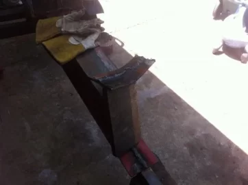

So I did get the wedge welded back on. I ran a few extra beads on the base too to make sure it was very secure. The seam is about the size of your thumb now. I ended up cutting the beam up too at every bend and welding it back together to get it straightened out, mostly. I really wish I had known what i was doing when i bought the beam and had gotten a thicker one. I could barely lift this one though so maybe I should just be happy. I tried heating it up and banging it with a 3 lb sledge to get the bends out, but there ain't enough boy in these britches to get it to move. It just made a lot of noise and annoyed the neighbors

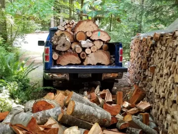

LOL. You had me going. I was actually thinking about this quiet and tiny splitter that you had and I had to have one as well. I do have several of those but they don't work anymore, LolI picked up a new log splitter a couple weeks ago and it's making quick work of all the downed trees from last winter's ice storm:
This is a load of mature Douglas Fir, a bit of Spruce, some rock hard and gnarled Maple and some Garry Oak (which was a surprising find).

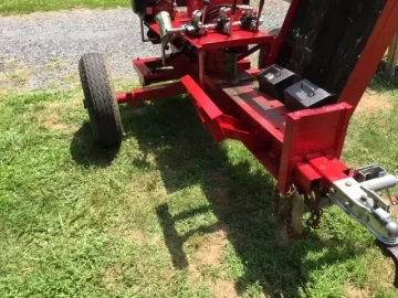

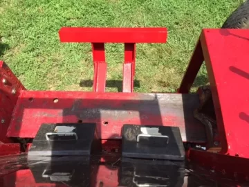

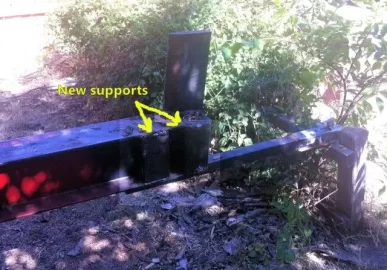

Nice...! My wedge isn't razor sharp, but I am pretty good with a file or a grinder; so my wedge is fairly sharp and I(me) think(s) a sharp wedge helps split the wood- especially if you need to go across the grain. EDIT: Now is the time to put a handle or tongue on the unit. (I could not see in my browser that you already had a tongue on it)I got the supports in and painted. There's now two sections of 4x2 square tubing on each side. I had to put him back to work so I didn't get to the wings and cupholder, but he's quite a bit sturdier now. I also sharpened the blade up nice. The only problem is I used to grab the blade and the tongue to move it around. Now I end up with sliced fingers if I try that!

Thanks Lloyd! I was observing the original photo I posted on this thread and I cannot believe the transition. I am looking forward to really trying it out this fall. Thanks.You got a heck of a piece of iron now! Looks good!
When I R&R'd the plate, circa 2012, I placed it so the wedge just touched it and the wood was completely cut, if necessary. With my new design, the blade of the wedge is further from the plate, due to the pilot or cow catcher and the real stringy rounds must be man handled. I am thinking of adding an angle or a strip of steel in the center of the plate and above the pilot to put the center of the round in compression and almost touching the blade of the wedge and keeping the outer edges in less compression. This is opposed to most of the round remaining in compression due to the width of the plate.Thats what I am going to do with mine as well...here is a pic of the recessed push plate.This allows you to set your split closer than you normally can and allows a complete split of the piece.
