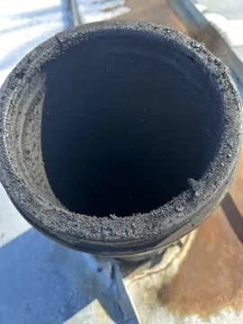

No history of the stove. It does have repairs done at the door opening corners, which is common. No history of when the chimney was cleaned, so in early December I got up top and cleaned the chimney. Then about a week ago, I cleaned it again. The pics I posted show the buildup after burning wood after the first cleaning I did in December, before the second cleaning about a week ago. I have never used an older wood burning stove before. Does this seem normal/average/excessive?

Welcome. A modern stove is going to use less wood because it is much more efficient. It looks like the old stove is burning a bit dirty. This most likely is due to the wood moisture. Drier wood gives off more heat. The stove should produce more heat and burn cleaner if the osage orange, walnut, and mulberry wood are allowed to season for 2 yrs. Ash may be ok in a full year of seasoning. Willow is not the best. It is very high moisture content and when finally dry, low btu. But as long as it is fully seasoned, it is ok to mix.

I do think this is dirty indeed.
I suggest cleaning often (and get drier wood).
I also suggest to add a flue thermometer probe (not magnetic surface). Mount it 18" above the stove. That will give you a better insight in how you burn (and how much energy goes up the flue). Keep it below 850-900 and above 300 or so.

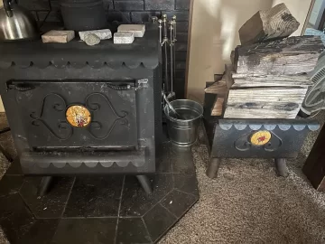

This stove does have 2 tubes on the back wall that stick up about 4 inches. Along with that, there’s a galvanized(?) pipe that runs up the chimney. Would those be secondary burners?
This is the best pic I have at the moment. You can barely see the 2 tubes/pipes on the back wall. Not seen is the pipe that runs up the chimney. This pic is from the December cleaning. (November 18th 2021 burning to December 12th 2021, plus October 2019 to January 2021 burning. Unknown cleaning before that).

Im just here to say I like the Earth Stove wood holder!
Same! It was a factor in purchasing this house/property, actually. Not IT, but the thought process behind it.
I figured if someone paid that much attention to detail as to purchase the “accessories”, then that attention to detail would be applied to the rest of the house/property. Sadly, it was not so, as I’ve come to find out as I’ve been doing repairs and discovering the “unseen” issues.

Thanks for the picture. Yes those two tubes were an early attempt to bring in secondary air. I am sure it helps some but not as efficient as the newer secondary air tubes they developed later. Some Earth Stoves had a steel plate below the flue to keep the fire from going straight out the flue this also helped keep more heat in the stove. This stove has had some good years of use and I am glad it is keeping you warm. This summer you can sometimes find some good deals on used wood stoves as they prices go down you might try to pick up something a little newer and will save on firewood and give you a hotter and longer burn times. Stay warm.
