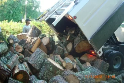

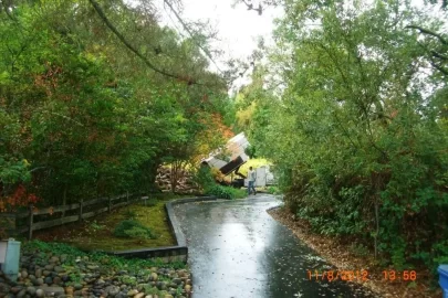

Well, it gets down to the mid 20's in late Dec thru Feb. But the real reason I burn so much is that:
1) Got a big house.
2) Three girls, Wife & two daughters = always cold.
3) I work out of my house so I am home all the time and often cook on the stove.
4) Electricity and gas are expensive.
5) While I have my share of hard woods, most of what I get are Arborist 7 yard truck dumps of pine and other soft woods which those guys can't sell to wood processors. But I have an unlimited supply of downed, limbed and bucked wood.

Cool looks like a nice property you have there!

Thanks but, any property thats "yours" is nice - anywhere in this country. I've seen some outstanding spreads from the other experts on this site and often feel humbled.
