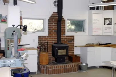

It's the same stove I have in my workshop. Pedestal with ash drawer. My instructions call for 0.446 in the hearth. Never paid it much attention, because mine's on 12" of masonry set atop a concrete slab...no combustibles at all beneath. Rick

Very happy with it, it's a nice little stove. Break-in fires will be pretty smelly...do them when you can have lots of ventilation. The stove's easy to live with, burns nicely, and the airwash is very effective at keeping the glass clean. I don't often bother with using the removeable floor firebrick/ash drawer feature, I usually just shovel the ashes out the door into a bucket. I like this stove, it serves me very well. Rick

man that is a sweet shop you have there. I'd show you mine but nobody wants to see that dungeon. Glad to hear it serves you well. Yeah I figure some the fall I'll send the wife to the movies or something and break it in. Do you get a decent burn time? 6 or 7 hours? Thats all I would need with our schedule.

Well, I really can't speak for the max burn time, as I typically don't load it up to the gills...and so far, anyway, my wife hasn't banished me to the shop overnight. I'm retired, and I spend a lot of time in the shop, though. During the burning season, I'd say I typically light it about 9 AM or so most every day, and burn in it steadily through the day until about 6 PM or thereabouts. My shop is not large, so I burn it steadily but at a modest rate, and I feed it additional splits throughout the day from time to time...plus, all I have to burn is softwood. With a good bed of coals and a nice load of wood, it will go into a real nice slow secondary burn while maintaining a good stovepipe temp, so if you've got good hardwood and you learn to load it to maximum effect, I imagine you could get 6 or 7 hours out of it with some remaining coals for relight. You'll figure out what works for you. Rick
