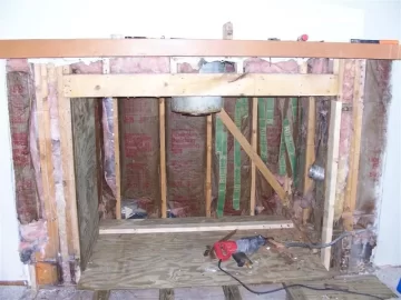

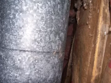

Trust me, you don't want to hook anything up to that preway garbage pipe. Your ONLY safe and legit option is to tear all that out and replace it with a UL listed Class A system UL103HT.
You might be able to sell the preway pipe on eBay, it is a hot item and hard to find.
I'll look on ebay, thanks for that idea.
I will have to respectfully disagree with GWB (aka. Pook, kooP, etc.)
You have had some very sound advise from Mike, Corie, JTP and others. These are the guys that are in the business and don't stand to make a buck off of feeding you a parts list you don't need. They are making these suggestions based on what will be the best and safest install. Please take that info to the bank. There are 2 things in Jags house that will not be compromised. Anything to do with electricity and anything to do with fire. They can both kill ya real good.
The pipe in the photo is Preway air-cooled chimney. It was listed only for use with Preway zero-clearance fireplaces, and is not approved to vent an airtight stove.
The other type of triple-wall mentioned in a couple of replies above is called air-insulated chimney
There are air-insulated chimneys that are approved to vent airtights (listed to UL 103 HT), but there are no air-cooled chimneys with that listing.
Can you render this air-cooled chimney usable for an airtight by lining it? No.
By packing between the layers with rock wool, cera blanket or vermiculite insulation? No.
By sealing it over at the top to trap the air and turn it into air-insulated chimney? No.
By mutating, migrating, mixing, merging, mating, or morphing it in any possible manner?
No.
If you want a safe and code-approved airtight wood stove installation, you must remove this chimney entirely, and install an insulated UL 103 HT chimney in its place.

Ok so there is 24 inches between the top of my stove and the mantle which is wood. My stove says it must have a 56 inch clearance between the top of the stove and the cieling. While my stove is not approved for an alcove how can I protect this mantel and not have the stove halfway into my living room? If I just close off the hole in my living room I will have to use a very long pipe to get back to the chimney and lose an awful lot of floor space in the process.
For me, that has always been a tough question to answer. Is the mantle considered a ceiling? or should it be considered a combustible and which measurements should be used. Maybe JTP or Stoveguy or Tom, or BG (or others) can jump in with that "definition".

Can you take a full wall shot of this project? I went back to look for one but couldn't find any. Otherwise I suspect you would have heard about the mantel earlier. If the pipe has to go and the veneer is getting messed up, hate to say it, but the tune going through my head is a line from Tobacco Road. (bring dynamite and a crane, blow it up and start all over again).
Shots below.

To further explain I have plywood that is cut fior the back and side wall, and I do need to get that on today. Next is the roof of this firebox area, then the durock,, etc. I'm going to build the front out for the proper clearance and then just have the pipe go back and up to the chimney pipe from the top of the stove. I've been told the diameter of the new ht pipe is roughly 8" and requires a 2" clearance. I have 5" from this outer 10" pipe, but on the front it is only 2". If I replace that pipe then that would bump me up to 4" to the studs and insulation on the side of the pipe that faces "in" to the house. Clear as mud right? lol
OK, that helps. I want to make sure I have the dimensions correct. Is this an FW247001? or is it an FW270007? Do you have the clearances sheet for this stove? I'm not sure if I have the right one, but if it is, you'll need 17.5" minimum clearance on each side of the stove, so add 35" to the stove width. Is the current cavity wider than this combined dimension?
This is an alcove installation. As for the mantel, looks like it will have to go. The stove will need to have 54.5" clearance from the top of the stove to the nearest combustible above it. Is this boxed area a bump out from the house? Is the pipe chase exterior or interior?
Firelion The whole thing you are trying to do is BOGUS! that chimney was for an old Preway fireplace and not designed for a wood stove. I wouldn't even sell you any parts if I knew beforehand what you were planning to do. Instead of looking for the cheapest way out and juryrigging everything why don't you visit a shop where the salesforce knows what they are talking about. Why take a chance on somebody at the Depot who probably doesn't have a clue about the correct way to do this. The big box stores sell the cheapest stuff they can get their hands on and only sell hearth seasonally. The components are usually brand name stuff but if they use the stuff differently than it was intended for you are asking for trouble. Remember you get what you pay for. and oh, one other thing, it's your house.
Why risk burning it down?
Well it is an alcove I'm building but a shallow one so the stove will actually be out in front. I will have the double walled chimney pipe connecting the stove to the chimney. It is the 07 I have.
I have all the clearances on this paper. Does this clearance from the entire top or from the front of the flue connector forward or what exactly? That will dictate my progress.
The width is 65" and the height of the opening is 45". The stove is 22" wide plus the 35" is 57" so I'm good on the width.
The chase is exterior. The wall you see with the mantle on it is the wall of the house.
It's for the entire top. And a 13" backwall clearance. By double-wall are you meaning class A pipe and not interior DVL pipe, correct? How will this pipe be supported? Are you removing the exterior chase cladding to do this?
So how does this sound. If I line up the back of the stove with the wall above it, I am outside the alcove, and I can remove the mantel and put up a stone one at a later date. No more combustibles directly above it. I wrote all the clearances on the decking I have down now and I'm ok with plenty to spare on the back and sides. I can finish the front deck to whatever it needs to be so I'm just hung up on the top clearance.
