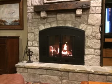

Update - OK, I ordered the unit in May, it arrived in July and I got to work installing it. Although I measured carefully, the unit was a tad too big to fully slide into the opening. It stuck out a couple inches. I'd recommend anyone ordering one of these to "shrink" their measurements 1/2" or so. I debated between taking the unit to the barn and subjecting it to the plasma cutter and welding rig, but opted to chisel and grind the rock to enlarge the opening. After that arduous task was completed, the unit now sits in fairly flush with the rock face. However, being rock, there was still some gaps to deal with.
The unit came with some felt stuffing, which I crammed into the cracks from the inside. I then went to Lowe's and found some hi-temp caulk that worked great for filling the gaps. It was fairly viscous so it didn't run down when filling the sides. It also set up very hard. So, last night I lit the first fire and it cranked the heat out into the room and made for a very enjoyable experience. There was some burning paint smell, but that will fade with use.
I definitely recommend this unit and I think I'm all set up for the upcoming winter. Now to go split some logs....

That looks great, good for you, enjoy it...
Congratulation to your new stove. That is a really great looking install. You will be happy. :)
Good call. Maintains your warranty, your insurance coverage and the safety of your family.
Right. Get some progressively hotter burns done now while you can still open the window to get the fumes out. After 3 or 4 times you should be all set.
Those are for the next winter, right?
Wow Viny, that came out wonderfully. It looks perfect in that setting. Thanks for the update. Nice job.
