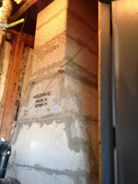

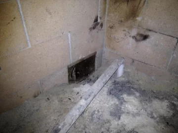

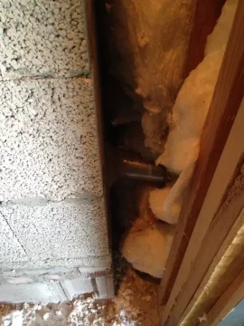

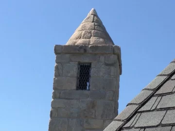

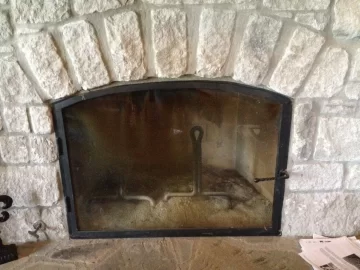

Ok, so I have a similar question. first for some background. When I built this house, I had this fireplace built from an Isokern kit, and I had the masons put in a fresh air inlet. I then constructed the (nearly) airtight door to turn the whole thing into an inserty type of creature. For all you experts, sorry, I like to tinker like that.
However, after several years, I am ready to throw in the towel as it just doesn't produce the heat a real insert would. So, I'm looking for an insert that would be appropriate for this fireplace that has the following features (no particular order): Wood burning, Fresh air intake for combustion, a domed flashing kit to work with the fireplace masonry, Glass Door to see flames, Gas ignition. I'm probably forgetting something, but you all can school me on that...
I have access to plenty of wood to burn as I live on a wooded acreage, I have gas built into the fireplace for ignition and an electrical outlet close by for the fan.
Anyone have any ideas, etc? What else am I overlooking that I need to consider before I leap?
Thanks in advance for any input, etc...
