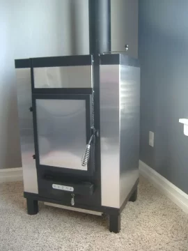

Hi, I am new to the forum and looking for another stove for the next winter. Came along this (broken link removed) made by Made Right Stove Co.
Can somebody tell me more about this stove.
Ok here is the stove
  • [Hearth.com] looking for a new stove for next winter
First time I have seen one. You certainly won't be able to install one like the picture shows. With no EPA or UL testing it is a completely uncertified stove. Call your insurance agent first. And plan on 36" clearances all around. As far as how it will burn or perform, no idea. The website doesn't say much about internal design and you only have the maker's word on warranty and performance.
I would pass on this stove with the lack of EPA and UL certs, he does not give any figures on the stove, just says it "sips" wood. I guess the same could be said of an old non-epa Fisher papa bear if you let it create a ton of creosote while the wood smoulders.
Much better stoves can be had in that price range.
I thought it was interesting
Indeed, it is and thanks for posting. It could be a decent heater. I have no idea. Seems light weight. I'd want to know more about the interior construction, baffling etc. before considering.
PS: Welcome to hearth.com
What's your current stove? Would the new stove be a supplement or a replacement?
I'd like to take a look in a 5 cu ft stove that weighs 180 lbs.
Never seen a stove on the carpet before, not even in marketing literature.
What's wrong with the Heatilator? I thought I heard good things about them.

The melting point of aluminum is 1220 F. The lowest melting point of iron is about 2100 F. I think you could over fire that stove and melt it.
