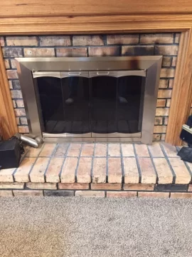

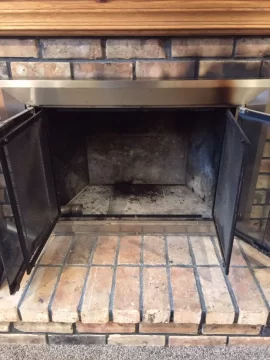

My house is a split level with 4 levels. The fireplace is in the family room in the first lower level(it has two ). I plan on burning as much as human,t possible and am looking for long burn times. I know I can't heat all 2800 sq ft but I want to try and heat as much as I can.The wife is looking for aesthetics, but I am looking for efficiency. I would like to put a stand alone stove in the alcove but the height would be an issue. Only 23.5 inches. I currently have a steel firebox ( not quite sure what that means) but the local stove shop said an insert would go in no problem. I guess I should ask about a stove.
Please post a pick.

Here are some pics
  • [Hearth.com] Looking for knowledge

Sounds like the local stove shop really wants to sell you something from Travis Industries. If you want some more options, post some more info.
Reactions: Bigg_Redd
Back up about 15 feet and take some more shots. I want to see if you can tear down the whole thing and just go with a free standing stove.
That's what I would like but I believe that would be more money, and the wife wants an insert. I'm gonna talk to stove shop tomorrow about the added cost
