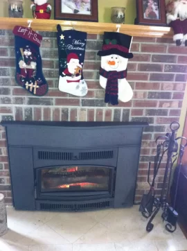

Facing the same problem that you have, my wife and I decided to install a wood burning insert inside our heat-loosing fireplace. We've been operating this unit - in our case a Hearthstone Clydesdale - see (broken link removed to http://www.hearthstonestoves.com/store/wood-products/wood-inserts/clydesdale-wood-insert) for about four years now. It's a well made unit that heats our 2000 sq. ft. ranch very comfortably. As you state, there are many other alternate choices. We also installed an insulated SS flexible liner that is connected to Clyde through an an appliance connector.
Poster yukiginger is right about the inserts requiring a fan. Most inserts need the fan to circulate heat throughout the house. This is true of Clyde also. But the requirement for a fan for air circulation can also said for free standing wood stoves as well. So much depends on your house design. We chose the insert over the free standing unit because the insert would not be so noticeable - as most of Clyde fits inside the existing fireplace. A free standing stove would just take up too much space in our living room.
You will need to install a new SS liner in your chimney if you install either an insert or a free standing stove. Most of these "appliances" have either a 6" or 8" exhaust flue. The size of your existing chimney is probably too large to achieve proper draft for a wood burring appliance. Many posting on this site would recommend an insulated liner. Your choices for SS liners are many, and there is some disagreement on this site as to which is better - a solid or a flexible liner. But that's a discussion for a different day.

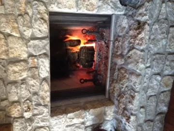

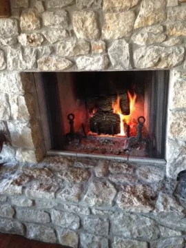

Thanks for the info... I forgot to add that we have tall ceilings in this room also. I will try to upload a photo of what I have. [Hearth.com] Looking for suggestions.... tired of this fireplace.
Fixed that for ya

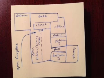

A floor plan (even rough sketched) would help.

Do the office & 2 bedrooms open to the living area?? Just checking !
Then, they should.
Here is a sketch of my layoutView attachment 125649

Looking at your floor plan, I suggest that you will need some circulation fans even if you go with a free standing wood-stove. A completely open house design might mitigate the need for fans, but the enclosed areas that you show in your sketch will likely get cold. A fan, or fans, in your cathedral ceiling would help - if you don't have one or more already.
There are engineers - HVAC engineers, actually - that specialize in answering the types of questions for which you are seeking answers. I suggest that you get in contact with one and ask what they can suggest for circulating air through out your home, given your interest in installing a wood stove. With the increased need for home energy efficiency, there are more HVAC engineers out there who can advise about heat flow throughout a home design.

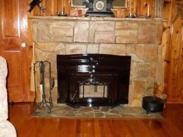

This is the one I went with;
Contrary to legend around here, your house wont explode if you install a Vermont Castings - but they did have bad years and are more complex/maintenance intensive than most and are not an ideal choice for a first timer.

BTW, if somebody told you that was a Rumford fireplace... well they dont know what a Rumford is. The slopes side walls is about the only similarity there to a real rumford, which is taller than it is wide and very shallow with both sloped sides and a sloped back. A true Rumford can actually keep a decent sized room toasty, but still is woefully inneficient compared to any stove.

I also did not want an insert, as I thought they looked like something that belonged on a tramp steamer rather than my rustic living room. I love mine, you can get it in majolica brown.

You need to know the exact dimensions inside your fireplace to make sure what ever insert you purchase will fit, plus a little wiggle room, especially on the top because the other thing you are going to want to do is install a stainless steel flue liner in that chimney.
