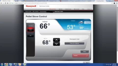

I still use the temp dial on the stove to set the desired room temp. The thermostat is more or less a fancy dummy switch (I normally leave it set to 80, even though my picture below says otherwise), that way the stoves controls dictate how it ramps up and down. Plus having the remote thermostat set to the desired temp may cause the stove to do a lot of short cycling as it hovers around the desired temp. If my memory serves me correct I went into the thermostats installers menu and was able to adjust it to only cycle on/off 2 or 3 times per hour. Thus helping to prevent short cycling.

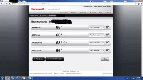

Here are a few screen grabs of online interface. The apps for the phones have the same look/feel.
[Hearth.com] Looking for WiFi thermostat for Enviro M55 insert for use with smartphone. Any suggestions? [Hearth.com] Looking for WiFi thermostat for Enviro M55 insert for use with smartphone. Any suggestions?
