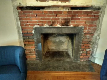

Hello,
I am looking for recommendations for a wood burning insert with a really big glass window.
My wife and I are first time homeowners. We live in a city and are not experienced with wood burning. Our new house needs some love, and we are trying to decide what to do with the fireplace. We got an estimate to re-line our chimney for $5500. It seems to me that the cost to buy and install a wood burning insert would be similar while being more efficient. My wife really likes the idea of an open fireplace, but she is tentatively ok with an insert as long as you can have a big view of the fire. Can you please point me in the right direction? Thank you.
The fireplace opening is 34 1/2" wide and 32 1/8" tall
Our house was built in 1933. It is 1700 sqft and uninsulated. It is constructed of stone and brick, and one wall is shared with a neighbor. The house is heated by an oil fired boiler, but it also has natural gas for cooking and hot water.
The reason the wall is damaged and mantel is missing from my photos is that the previous owner had constructed a floor to ceiling brick wall in front of the original wall, and in the process he discarded the original mantel.

The inserts with the largest glass that come to mind are the Hearthstone Clydesdale, Lopi flush/Cape cod inserts and the Blaze King Sirrico/Ashford insert. The Blaze King being the most efficient of the line up.

I'm with webby. HS Clydesdale has a large view, big heat too. Jotul's Rockland CB550 Clean face version has a large open view. Quadrafire Voyager Grand does as well. Lots of nice choices out there, try to check out many and get the compromise of good looks and heat output to make all happy. Good luck.
