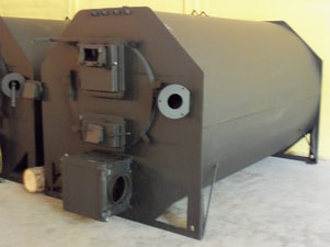

My wood burning unit has a built in oil burner for back up. Bought it 8 years ago and they're still being made. I'm also in CT.
Good unit, but I believe the original post was about combination forced air furnaces. There’s plenty of combination boilers still out there I think. I don’t know how many are EPA approved and/or tax credit qualified though
