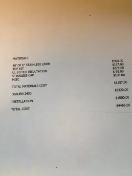

Here are the quotes:
Osburn 2400 insert - $4486.00 total cost (installation $1000 included)
Osburn 2000 insert - $4110.00 (installation $1000 included)
(quoted for 18' of 6" stainless liner, insulated)
Lopi Freedom Bay - $4274.90
Lopi Freedom - $4171.10
QuadraFire 3100i ACC - $4689.00

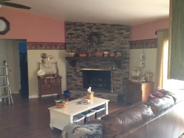

My floor plan is very open with high ceilings in the living area. House seems drafty compared to my two story that I used to live in. I'll post pictures of the floor plan and of the fireplace. I do worry about the height of the mantel. Two people who came out and quoted said I would have to get a mantel shield or move the mantel up further.
I really wanted to spend between $3500-4,000 dollars on this project. I just never really thought that installation would cost so much. I may hold off until this summer to install one as I do not have any wood cut up at this point. I was going to start cutting wood now. What would you guys suggest for heating my home. I plan on trying to burn as much as I can, but might not be able to keep it going 24/7 because of my work schedule and kids. My wife is home all the time, so she would be able to keep it fed. Any help is appreciated. I just don't know what to go with?? I really like the Osburn 2400 because I cannot find a bad review online concerning this stove and it puts out a lot of heat. On the other hand, it does stick out on the mantel further and I like how the lopi freedom bay sits back in further. I do like the larger fireboxes and from what I've read, everyone says get the biggest box you can get or you'll regret it.
One thing I might add: The photo was when I bought the house, so that is not my decorating or paint on the walls. We've painted everything the house looks much better!!!

The detailed quote that I received for the 2400 was for $2329.00. When I configured the stove on Dynamite buys, it was the same price. I believe it's really the installation cost that is killing me.

So roughly $2300 for the Osburn 2400 and $1700 for the installation, is that correct? What I am not understanding is where the $1000 installation price is coming from in the original posting. Is that for labor only and then $700 in parts? If this is a two story, insulated liner installation then the price is not bad for this time of year, especially if this is a steep roof and it is icy or snowy.

This is a ranch and the roof is not steep at all. The installation looks simple other than cutting the damper out and putting some sort of damper sealing kit. I would do it myself, but it just scares the hell out of me when it involves fire and my house and the safety of my family. Please see quote attached.
$2157 seems a bit steep for an install. If you feel confident in your skills, we can help you with the self-install. That will knock off over $1K from the estimate.
The $1157 in materials seems high.
