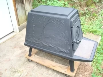

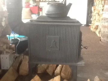

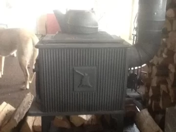

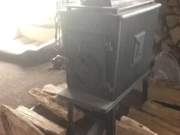

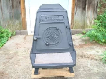

I am looking to get a Energy Harvester MC. I want to get more burn time and be able to burn a larger piece of wood. Attached are the pictures and the guy is asking 450. It is completely re furnished. What are your thoughts? What is my upland worth? It is also re finished. Should I upgrade? Thanks

I would look for an EPA stove (post-1990) that re-burns the smoke, either with a catalytic combustor or burn tubes in the top of the fire box. More heat with less wood, and a clean burn.
Reactions: raybonz
i looked at differant sized stoves and I liked the large firebox on the englander 30 and the price at home depot was 699. I am very happy with it. And the glass in the door makes the fire look nicer.
I say don't buy it, for a couple hundred bucks more you can get the latest burning technology. You can burn longer, cleaner, and use less wood doing so. Just my opinion. Plus get a glass door and look at the fire. Burning wood and giving the gas man the middle finger is still fun.
Keep looking. You can find far better deals in the $400-600 range on CraigsList.
Reactions: etiger2007
I don't need the glass. I nice strong work horse that looks nice in the summer time. My house is rustic with tounge and groove pen walls. So the design fits perfect. It is just a perfect size because where it is located i need it more deep than wide stove. Is there a EPA model stove that measure 15 to 18 wide by 25 to 34 deep

First how many square feet is your home and do you want to heat it all ? This is very important in the stove decision. There are stoves in that range on craigslsit that are EPA as woody stover pointed out. I would also think about setting away 2 years of split wood due to EPA stoves needing good dry wood . They are far more efficient take less wood throw heat longer and will be less work all around.

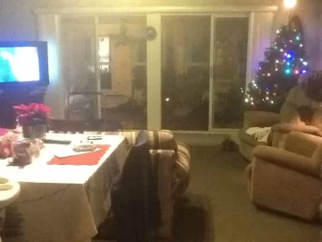

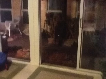

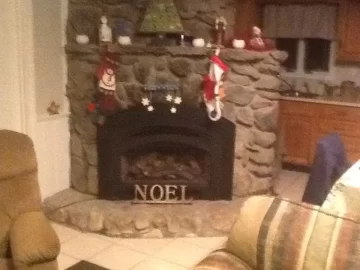

My house is small about 1200. Kitchen and living room are in one big room and there are 2 bedrooms off that. One is my daughters room the other is her play room. My bedroom is thru a hall. This use to be a car port they converted. I live in a converted cottage. I attached some pictures. I have a picture of my fireplace that has a gas insert. It will get to hot if I get one there. Thanks Brandon

Brandon that is a beautiful home you have. I would be looking for something along the lines of (broken link removed to http://www.homedepot.com/buy/englander-1-200-sq-ft-wood-stove-17-vl.html#.UNOvWaXv6s0) you could heat your home and possibly use less wood. You can find a lot of good 1200 sq ft stoves under $800 and you would benefit greatly by investing in something that would heat your home if you are going to spend the money. I am assuming you are on a budget for the stove of course ??

If I remember correctly it has a bit larger of a firebox and PE stoves tend to have reports showing that they have longer burn times then a lot of other non-cat stoves. The 13 has a relatively short burn time of around 5 hours.

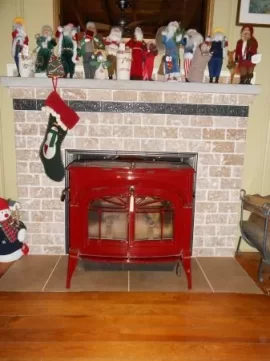

Is this a good stove for $500.00 Vermont Castings, Defiant Encore, top and front loadView attachment 85792
Vermont Castings makes some beautiful stoves, but they have a reputation for requiring more maintenance than most, due to their numerous gaskets. If you're the type who likes to tinker, then it might not be a bad stove. If you want to just install it and use it, and not be bothered with summer rebuild projects, it may not be the best stove for you.
BAR is our resident VC expert... I'm sure he'll have more to add.
Did you mention where you live? If so, I missed it. Important info for picking a stove.
