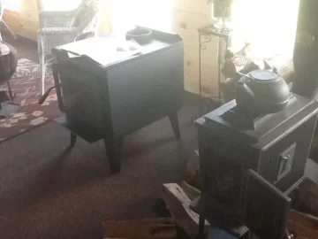

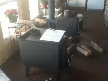

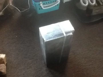

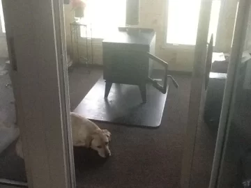

Ok guys. I am a owner of a True North stove. The old one is cooling any break in tips?

Congrats Brandon just in time for the cold! RTFM for break-in hints and I will allow others to chime in on break in but I think you should make 3 small fires let it go out with each a little larger then burn on.. You will get some paint smell so you may want to crack a window and use a fan to blow the fumes out..Be sure to post pics and review your stove here to help others..
Good Luck!
Congrats! Can you take it outdoors, stick a 4' length of 6" vent pipe on it and fire it up outdoors? If so, that will save you some stink indoors. Otherwise open the windows for the first couple burns.
Reactions: raybonz
If I had had the option of curing the paint outside, I would have. I occasionally still get paint smell in the house on a hot burn, although probably from the double wall stove pipe that never got hot enough before (it's only been burning for a couple of months).
Good idea BG but I have the feeling since he removed the old one he will want to fire that stove in the house.. It's pretty cold here right now so maybe you have best idea to keep the paint fumes outside..
Ray
Steel stoves don't need much of a break-in. Do a small fire to dry out the firebrick. Let the stove cool for a couple hours and then do a medium sized blaze with enough wood to get the stove top to about 500-550F. Repeat once more tomorrow morning and take it up to 600F. It should be pretty good by tomorrow night.
Reactions: raybonz

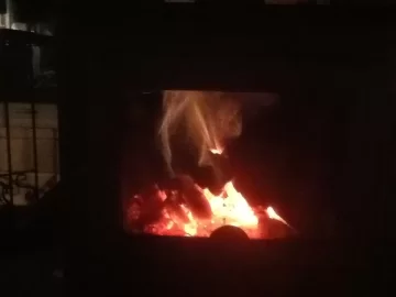

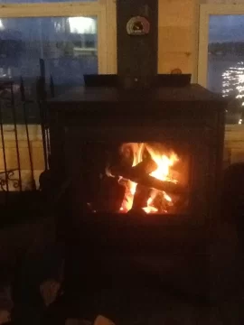

And we are off. Where should I put my temp gauge it is magnet
On my stove I place the thermometer on the top near the stack.. You will need a probe type into your flue pipe to monitor the flue temps due to dbl. wall pipe..Yay what took you so long? :) I tried to call but no answer! You're gonna see a big difference in wood consumption with the new stove! BTW your camera sucks!
Ray
This has to be some kind of record from first query to first fire!
Regarding thermometers, there are all kinds of threads here. You may consider getting an IR "gun" type. The magnetic types are usually accurate enough for the purpose, but they have a lag time. I like to use an IR, especially when it's warming up, and you can use it all over the stove and for other things as well.
Reactions: raybonz
It is the built in camera. Makes it easier to post. I can't find my phone. Lol.

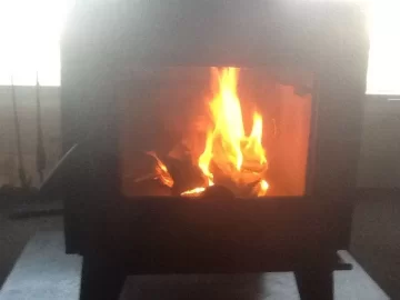

Stove was struggling with my damp wood. On the edge of burn zone. I got frustrated and drove to Walmart and bought 4 bundles. I put 2 pieces in and HOLY chit the secondary burn is awesome. The whole house filled with smoke because we got the stove hot. Lol. It is around 300 degrees.

LOL yes the paint will smoke for a little bit but probably have it baked on now :) The secondary burn is awesome to see and why you will like a nice window..

300 is not a high temp on a stove in fact your stove top will exceed 650 degrees with normal temps between 500 and 650 and peaks to 700... Yes they get that hot lol.. I have a thermometer and also an IR heatgun to keep the bimetal temp gauges honest..
