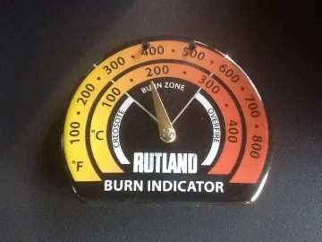

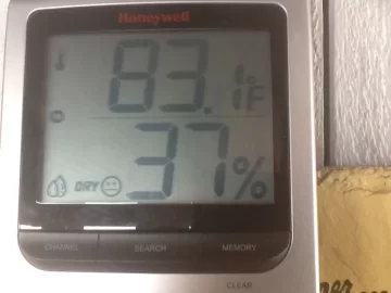

Got back from Rays and loaded the stove up temp in house was 64. Went out side to do some splitting. Came back in about an hour later. WOW. Good wood does work well. I have the stove almost all the way closed to the right. I am going to take a nap now. Lol. Thanks Ray and the team with the advise.
You're welcome! I think you know the difference dry wood makes.. Did your secondaries light off (burn tubes with flame)? You will have to post a pic when it's cruising along and run a full load and let us know the burn time and other stats :)

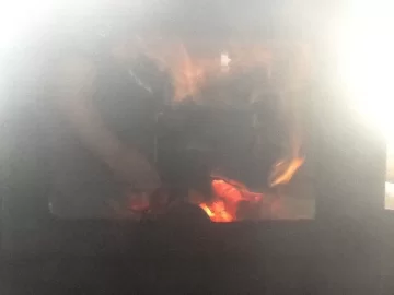

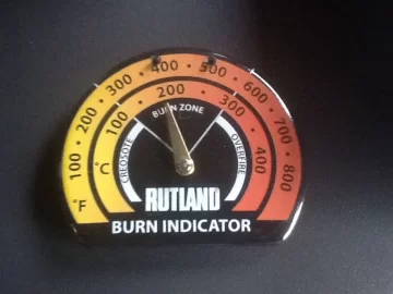

Vent closed. Loaded it 1/4 way at 9:30. Just reloaded. Secondary's are fired. I can not imagine this stove at 550

Ray l loaded 1/4 of that wood
Looking good! I'd say your secondaries are going well.. That stove can cook you out of the house lol.. On milder days like right now you need to run smaller fires then load up for overnight burns.. There is a learning curve with every stove and installation.. Lots of variables..

Sounds like you might need to get some heat circulating. How warm are other parts of the house?
Hi guys another question. I stocked the stove for the night about an hour ago and it is getting hot top of stove is 600 vent is closed to the right. Fire is rolling . What causes the glass to get dirty? It was dirty on the sides now it is creeping up from the bottom? Is this similar to a pellet stove to clean? What causes it?
Usually it's moisture in the wood that causes the build up on the glass. It also happens when you shut down the air intake too soon. Dryer wood usually burns hotter and keeps the glass clean.
Congrats on the new stove. Merry Christmas! If you can get your hands on some construction debris, or pallets you can cut that up and mix it in with your unseasoned cordwood. We all struggled through our first year. Get ahead on your wood supply so this is a non issue for next year.

If you have wood very close to the glass, that might cause it to cloud up more as well...
Thanks everyone. I got 7 hours of sleep which means the stove went 7 hours. This morning there was still wood and a lot of hot coals. I piece of raybonz's wood and we are off again. Thanks again. As for the glass. I did throw in some damp stuff.
