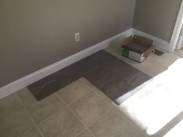

Hey guys, need your advice. The BK Ashfords only need ember protection so I can't see spending $600 on a hearth pad. I have purchased some tile and am wondering if just throwing it over my laminate with some thin rubber cushioning under it is a smart idea. Worst case scenario I'm thinking the stove cracks one when it's put on it or at the very least, tips up an edge or two of the tiles so they don't lay evenly. I can live with it I think though...Opinions?

I'm pretty sure vinyl sheet flooring like this is glued down. These don't look like tiles to me..but I can't really tell.
He didn't say vinyl sheet flooring (aka linoleum). He said laminate but then showed a photo of a tile looking thing. Is it tile, linoleum, or what?
I should have clarified. Sorry. It's linoleum. Ours is glued down.
