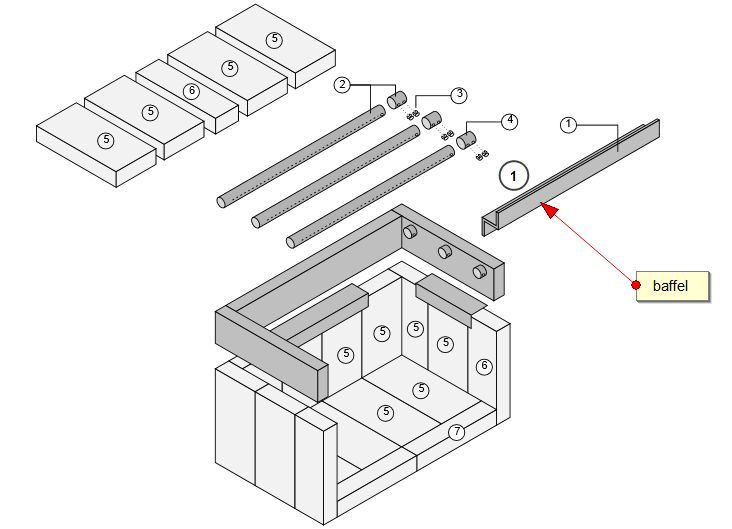

Hello everyone, and happy turkey day. I recently purchased a used Lopi Answer wood insert stove (from Craigslist), and one day while the girlfriend was putting another log on the fire, the support baffle comes tumbling down. I'm having a rather difficult time getting it back in place and having it stay there. I've checked the manual and have tried different configurations on trying to get it to remain situated. Keeps falling down. So if anyone has any advice, it would be appreciated. BTW the local dealership here (Seattle, WA) is less then happy to help because I did not purchase the insert directly. thanks

Just replaced that piece on my Lopi Endeavor, same setup. The bricks hold it in place. Slide the top row of bricks foward into the baffle.
I just made new ones for my liberty. Maybe they are warped from the high heat like mine were.
