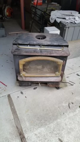

This is how it came off the truck:
[Hearth.com] Lopi Freedom cracks in firebox and rusted damper

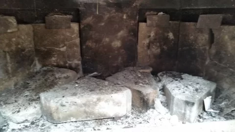

Inside:

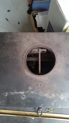

Missing bypass:

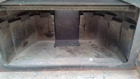

This stove was neglected and beat up. The firebrick was cracked and it was rusty from the leaking flue cap. The air damper at the bottom is rusted and won't move. I thought I would clean it up and see what I have. I scooped up at much ash as I could then I opened the door and blew it out through the top exhaust with a leaf blower. I also blew out the passages between the firebox and outside metal. Tons of dust and debris came out. This is what I have:
Cleaned up:

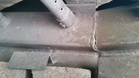

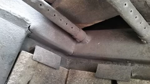

Then I looked inside and found the cracks:

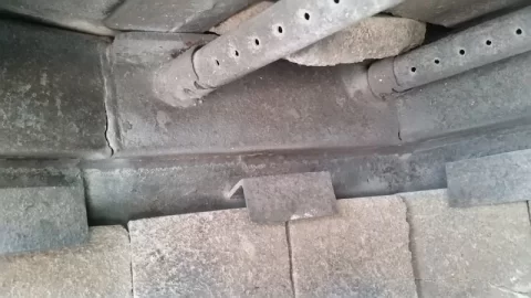

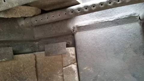

This was a discouraging find. Has anyone had success welding cracks like this or welding in repair plates? I would like to save this stove if I can. Please share your experience with this type of problem.

Yes you can have those cracks welded up. It's normal for an abused Lopi..
The bricks, I'd leave them be considering its a free stove. Cracks in the bricks won't hurt a thing.

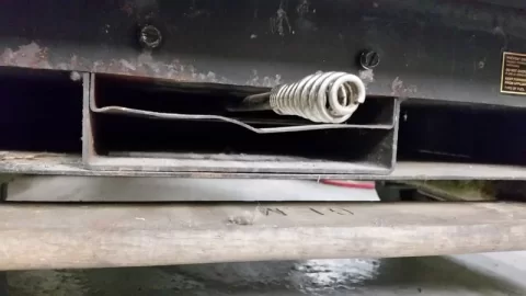

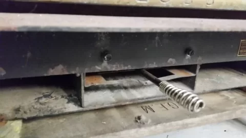

I just went out to the garage. The metal below the air control was bent. I didn't see a set screw. I got the metal bent down and the air control came right out. Would you mind taking a picture of what the set screw should look like? I assume it should go in the hole in the center below the handle. The metal there is thin there are no threads tapped in it.

I can't take a pic, I don't have a Freedom anymore. Just going off memory from my experience.
Thanks anyway. I think what I'll do it put a small bolt and nut through the hole. It will stop the air control from coming out when it is pulled forward.

I'm sure that hole is where the screw would have been originally.
I'm no welder, I've just heard of others having it done. A stick welder is what I would think is best.
I don't know your welding skill set. I recommend you get someone experienced to show you how to weld it up. You can make it worse if you don't know what you're doing.
That metal is likely pretty thin so an arc welder will just blow a bigger hole in the crack. If you're really good with a stick you can probably do it but you will have to turn down the amps so low that you will likely end up with bird poop welds. I've welded exhaust tubing with my Lincoln stick welder, it works but is not pretty.
Wire feed is the better tool here. Less heat. No reason you couldn't add cover plates and weld them over the cracks if you find that easier.

Good advice. I've never seen a stove with more weld cracks.

I visited a friend that had a wire welder this morning. The cracks are welded. Now I need to get a bypass and bricks for the stove.
The next step will be sanding and painting. It is a relief to get the cracks closed up. I am confident I can save this stove now.

Welding the cracks is easy welding them well enough they will hold is a very different story. Most repair welds on stoves i have seen have failed.
What should I look for in a proper repair?
one that doesn't crack. It is next to impossible to tell how good the repair is from the surface there are many things that could go wrong from inadequate penetration to overheating the metal next to the weld weakening it. that being said those cracks are in no way a safety issue and will only affect performance a little bit. If it cracks again I would just have some stainless cover plates made up to protect those areas and minimize air leakage.
