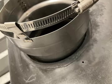

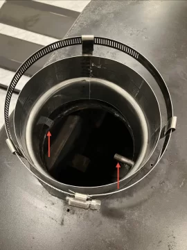

Maybe I’m overthinking this, but the flue connection for this Lopi declaration insert doesn’t seem like a very good design. The appliance connector is a loose fit at best and only engages about 1/2” into the stove collar because of a welded tab that I assume is to prevent contact with the damper rod. The manual doesn’t speak to sealing this interface at all, just securing with the 3 screws and brackets. Is it worth sealing around the connection with furnace cement or something more robust? I’m also contemplating cutting a notch in the front and back of the appliance connector to allow it to seat deeper in the collar without contacting the damper rod. Would this cause any issues?

The adapter can be notched to clear the bypass rod. The gap should definitely be sealed by using some flat stove window gasket or furnace cement, or both.
Is this the style gasket you would recommend? And does it matter how far the connector extends into the stove? As in should I bother cutting the notches and if I do should the connector go all the way down so the step where the liner bottoms out is resting on top of the stove?

Yes, that would work, though the 5/8" width might be better. It will allow room for a good bead of furnace cement to sit on top of the gasket.
I notched mine just as you described, and used furnace cement. The furnace cement always seems to crack and fall out after a season or so, not sure why exactly, likely too much movement between liner and stove. For mine the fit is snug so the lack of furnace cement doesn’t bother me.
Reactions: begreen
The metals of the liner and the stove expand and contract at different rates than the cement. That repeated movement leads to cracking of the furnace cement.
