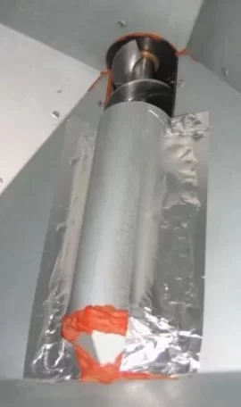

Do you have any aluminum foil furnace tape? You could use that temporarily until you get the silicone. Also, did you take the side covers off and clean the ash trap behind the firebox?
here's what my Astoria looked like when I used the tape to help make the pellets slide easier....should be good enough to tell if it's the lack of seal that's making the poor airflow:
Yes, I will check and see if I can find some furnace tape. I assume that duct tape is not for this application because it has cloth in it, correct?
