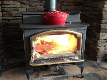

here is pic of the stove I am considering

Looks well cared for from the outside. The firebox/brick/baffle/secondary air tubes all need to be thoroughly inspected when the stove is empty and cold. Rick
That's the size of my living room where the stove is located and like I said its usually 85 to 90 degrees. Looks good from the outside, but before you purchase it, I would ask if you could come and inspect it. Look closely at the air channels inside of the firebox for any signs of cracking or broken welds
