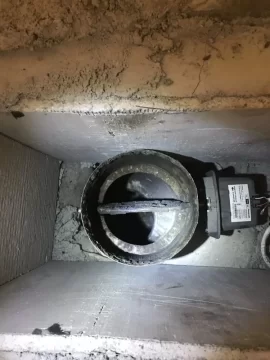

Automtic damper - I have one on my masonry heater. Work great
  • [Hearth.com] losing heat up my flue
