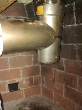

Yes, here you go. Sorry I tried to include this in the original post but couldnt find the 'attach' option. I undo that single screw and remove that bottom cover.... Edit: I guess 'cap' is a more accurate word for what I removed. I took that off and went straight up that opening with the soot eater.

Ah, that it the liner tee cap. The raining sound may have been creosote burning in the liner. How was the wood dryness last season? What temperature was the stovetop with a typical fire?

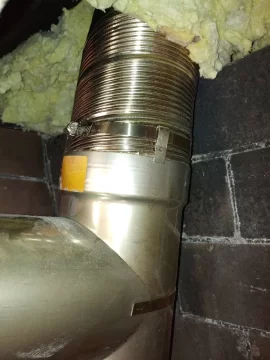

There is no block off plate (just insulation around the liner), and I am awaiting an answer from the retailer/installer on whether the liner is insulated. I will post another closeup pic of the liner above the thimble, maybe one of you can determine whether it is insulated from this?

You could just pull out the insulation to inspect the liner. Then stuff it back up there. Wear a mask. Is that regular fiberglass insulation or more like white kaowool?
