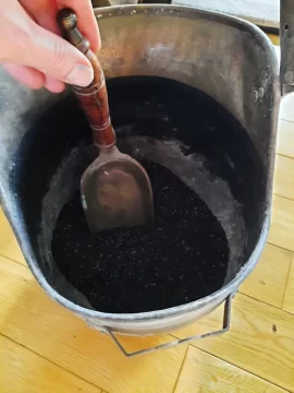

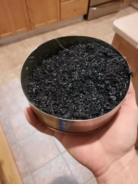

Hi All,
I may end up starting a new thread as this one is pretty old, but since it is all a part of the ongoing discussion... Kenny, I took your suggestion and cleaned my entire liner again as I just finished burning my first cord of the year (maybe just a tad more than a cord actually). Anyway, I still got quite a bit of creosote. See pictures attached. I am confident that my wood is well dried (20% or less) based on testing it per everybody's instructions with a fresh split and meter into the clean face. My question is 'is this a lot more creosote than should be expected after burning just one cord?' Assuming this is just the reality of how much creosote my setup will be producing, and there are no obvious/quick solutions to reduce the buildup, how many cords is it safe for me to burn between cleaning the liner? Doing it is a bit of a PIA and I would rather not have to do it 3-4 times a year (I expect to burn 3-4 cords/year).
Thanks all.

I wonder how much air that cleanout cap is leaking, if your getting a bunch of cooler air mixed in with the exhaust gasses that will create creosote as well. I would try burning an incense stick near it the next time you burn to see how much smoke gets drawn into that cap.
