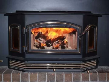

Here ya go. She's a beautiful beast. Looks like it could heat the neighborhood.
  • [Hearth.com] LOVE my 5100i Quadra Fire
Man alive that is a nice looking insert.

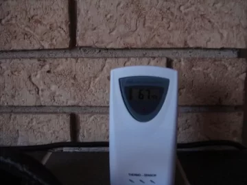

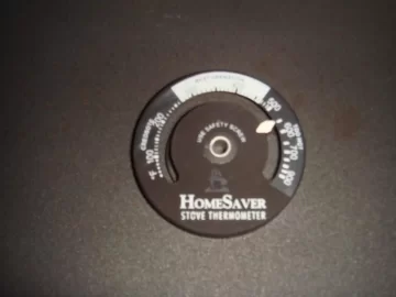

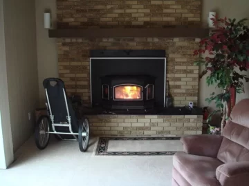

I found this thread searching for help on my 5100i. This is now the 4th season I've been trying to get satisfactory heat from mine. I've called the manufacturer with no luck. The pics show where the thermometers are located and what temps they are at. Pretty sad considering it is 38 degrees outside. This room is quite small as you can see. You could just imagine how cold the rooms get on the other end of the house. I use 24-30 month seasoned oak this year and still no luck. I've just come to the conclusion that this model just isn't all that great. It is rated for a 3500 sqft. home and mine is exactly half that. Imagine that. Any suggestions from other 5100i owners? Temps read 550 and 67. After I posted them they look a little difficult to read.

The air coming from the blower outlet is right where you see the 550 temp and yes it is rather toasty. One of the questions I had asked the manufacturer a while back is if they had any larger volume fans and the response was that a large volume isn't what I'm looking for as I only want to keep the heat softly moving. Once the fire is going well, I try to keep the air control closed as much as possible (without restricting flame). As for a block off plate, I'm not quite sure as I don't know what that is. The chimney is rather large and my 6" pipe runs up the middle to a cap up top. The stove runs 24/7 and the chimney in the garage is barely warm to the touch.

One thing I should note is that the fireplace opening is HUGE. If you look at the pic I posted, you can see the additional plate I had to use to cover the opening. Although this is a very large insert and is rated for 2 times my house size, do you think the majority of the heat is going straight up?

Also you might not have the temp gauge in a very good location, try putting it on the face just above the door or if it wont fit there stick it right to the door frame. You should actually get hotter temp readings there than by the blowers. Although this is a guess since I don't know exactly where the blowers are on that unit. We only sell 1-2 a year just due to its huge size; almost no one can fit it in their fireplace. Regardless you want the temp gauge on metal that is directly exposed to the firebox.
